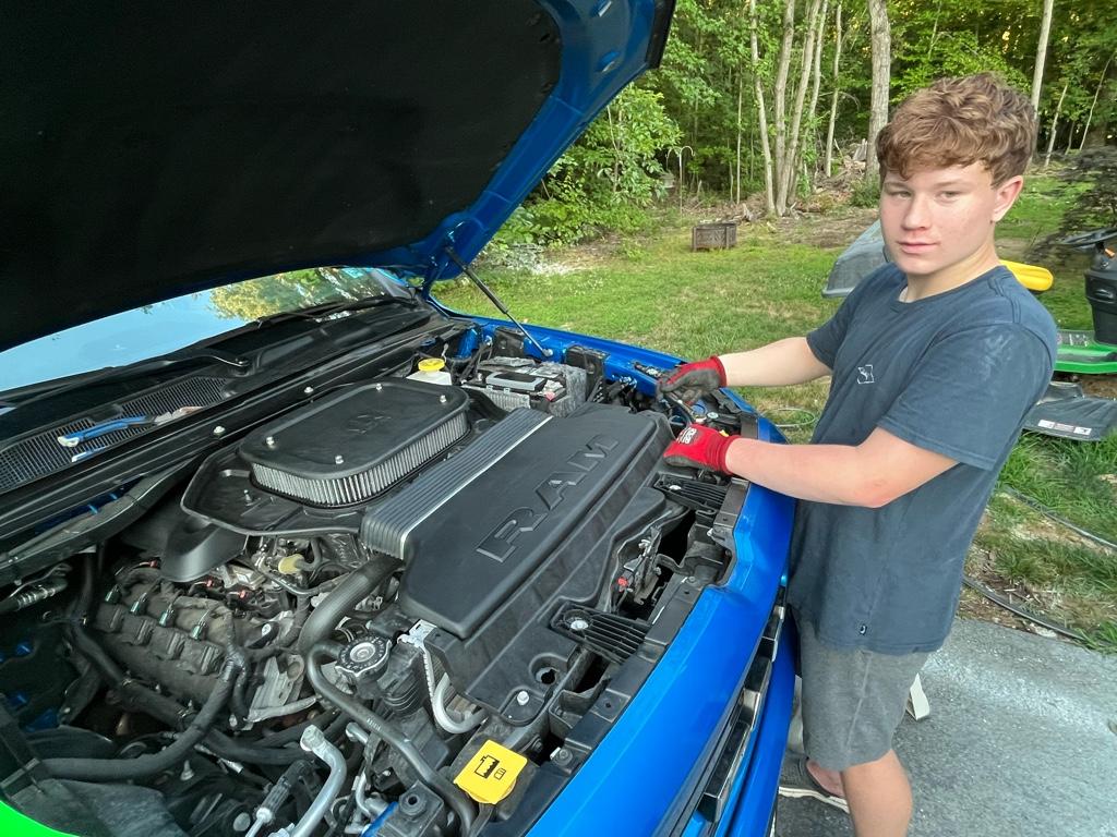

Looking for insight from you all who have installed long tube headers into your rams. I installed the Mopar cat back system last year and the Ram airflow with my son a few weeks ago. I am looking into completing the mod with long tubes but have a couple questions.
1. Are LT headers compatible with the cat back system? (It was expensive so I want to keep it)
2. Will LT headers throw a code?
3. Is it worth it from a power gain perspective?
Thank you all!
