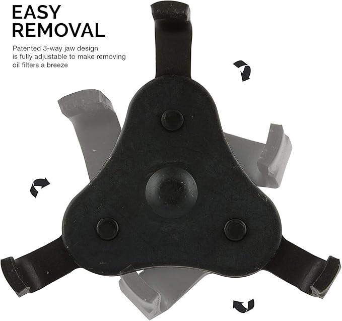

I only ever use a filter wrench to take it off. New filter goes on by hand. Contact + 3/4 to 1 full turn shouldn't require a wrench. I use this style to remove everything big, little, and in between:
Walmart has a similar filter wrench for I think $5.95. It was in stock despite what the Walmart internet site stated.
