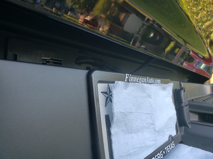

I was washing my truck yesterday and I noticed the bottom of my tailgate has paint rubbed off. It is hitting my license plate cover from the looks of it. This appears to be a bad design by RAM. Do you think this would be covered under warranty?

Sorry, I have to agree with the other responses: no way that's a warranty claim. If the plate doesn't rub without a frame, then it isn't warranty claim as frames aren't a factory option. Even so, I would bet the advertisement frame your dealer installs (assuming that's how they advertise) wouldn't rub either - I know the one on my '20 1500 doesn't. Is that a PSU alumni frame? It looks really wide at the top & I think that's the issue. Try a frame that isn't as beefy up top & it probably won't rub. Or - I don't know if this would work or not - try elongating all 4 holes in the frame in the top-to-bottom direction to get the frame to sit lower. That might work if there's room for it to move down towards the bumper & there aren't nubs holding the plate in position in the frame. If the plate is held in position in the frame, the plate holes would have to be elongated too if that looks to be an option.
I checked mine and it's way closer than expected. The plate from was installed by the dealer, advertising, and I might pull it off seeing how close it is.
I did notice that my plate frame is almost flush with the top of the plastic plate area.

Had the same problem when adding the VLEDS reverse light to the license plate. Had to trim bottom of license plate 1/4" and re-drill holes to mount it lower. I would not have done it just to add a cover, but I have had these reverse lights on other vehicles and like them. It rubbed until you lowered it.

As for the scratches that are beyond the clear, you can touch that up with touch-up paint, let it cure for a week and then have a good detail guy do a very light buff to smooth it out. It will be very difficult to see after that.
The touch up paint will fill in the deep scratches and blend in while the lighter scratches will buff away.
