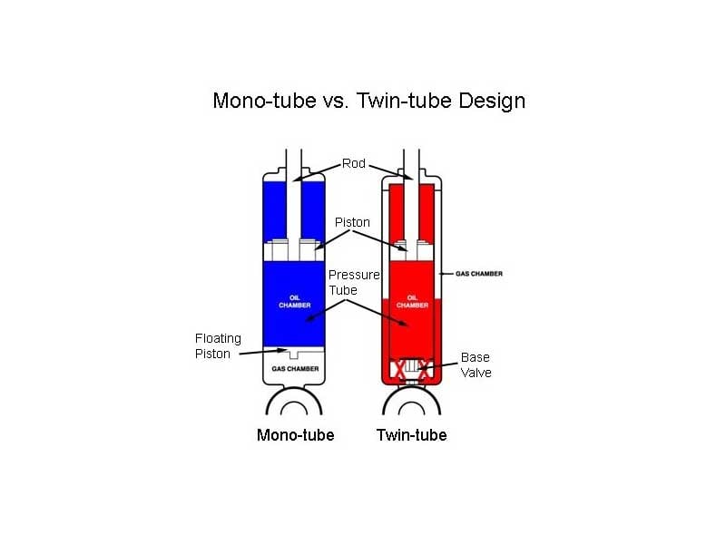

If you go RC, do the M1 upgrade Monotube over Twin tune N3. Definitely change out UCAs. I have seen people mention KSP, but doesn't seem often, so do your research on them if you go that way.
