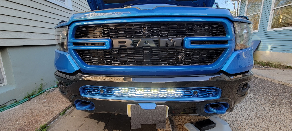

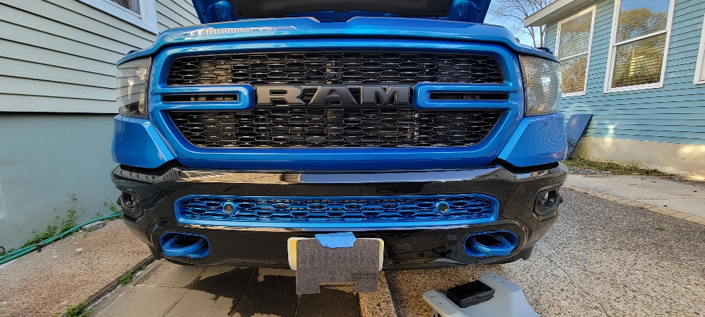

Installed my rough country 20" light bar behind the lower front grill.
I had a 2021 rebel and that lower front grill was 2 pieces sandwiched together. On this big horn back country trim, it was one piece, so I had to get the part number for "see-through" grill. Once I got the piece, I painted it to match the truck. I'm happy with it.

Do you have the “see through “ grill part number? Mine also has the solid lower grill.
Yes mpg is starting to get better. Only have 700 miles on it so I guess wait and see.
Yup...here you go:
68334531AD Lower Grille
Just a heads up. I had to go through a couple of different sites to get it. Each one I would reach out to, they asked for my Vin, then said the part doesn't fit original factory VIN. I told them in not looking for the original part, because thats not the part i wanted, but they continued, so I tried another place.
I ordered it from BAM wholesale parts. Just typed in the part number and found it. Then shipped it with no questions asked.
Part was $47.

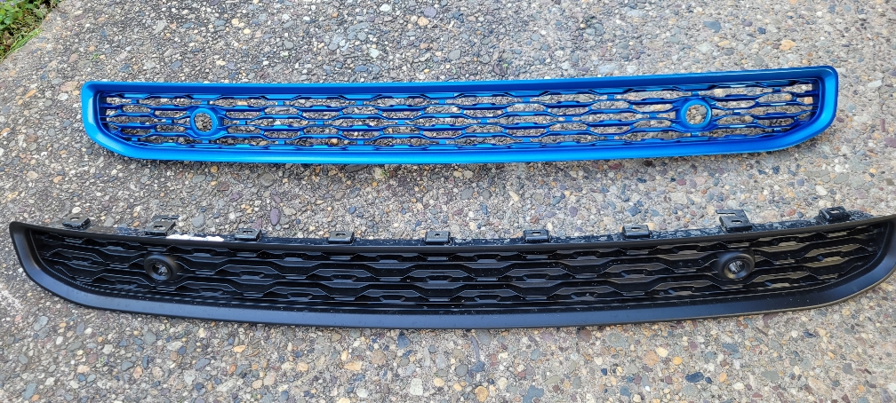

To add. Here is a side by side comparison from old and new. New one I painted, but it came in the same black paint
