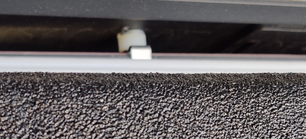

Clips are included with the opt7 bar. Purchased 1/4 and 1/2" spacers at home depot
Here is up close picture of clip with spacer on back of light bar.

It's only 48 inches so it doesn't have to curve as much as the 60 inch at the ends so it sits flat on the plastic piece under the tailgate. I used these about 6-8 inches from the end. Put a drywall screw through the middle to hold them on with the adhesive and then used a small cable tie to hold the bar in place that way it's easy to remove if need be. Also used my curt adaptor from my previous Ram and wired the reverse lights in with a bullet connector again for easy removal if required.
Pics of the bar are on my thread, Post 25.
