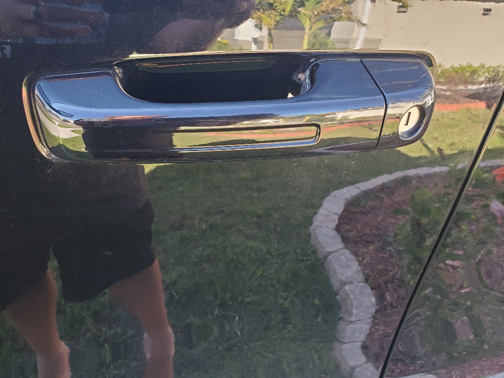

I have read a number of other posts revolving around this topic but have not seen any info regarding the specific question I have.

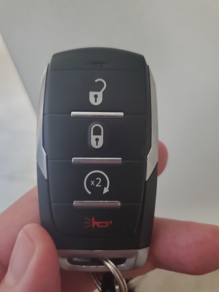

I have a 21 Ram 1500 Big Horn, and it came with the remote start system, and according to the sticker "remote keyless entry". The remote start works fine. However, I have never been able to get the keyless entry to work (grab the doorhandle with key in pocket to unlock/lock the doors). It does have power door locks, which I can control by pressing the buttons on the key fob.
In the manual it says to enable it in uconnect settings. However I do not see the option to do so there, I'm guessing the code isnt programmed in which enables this.
However, I began questioning whether keyless entry was even really installed when I watched some Mopar instructional videos on how to use the keyless entry (and read the manual the manual), which both show a little button on the door handle. My truck does not have this. You can see my driver side door handle in the attached pictures.
So my plan was to either use AplhaOBD or the Dealership to program the code in to enable the keyless entry, but wanted to make sure I have the proper equipment installed (correct door handles with sensors and correct key fob) before I spend money on either of those options.
If anyone can provide any clarity on these question, I would be extremely gratetful!

keyless entry means you do not use a key to unlock the truck
you are thinking about passive entry
you can add it

I had a 19 big horn with the same Keyless entry. Yours works the way it's supposed to. You don't have passive. You have to use your fob to unlock the doors.

This gets a lot of new Big Horn / Lone Star owners. Keyless just means you aren't physically putting a key into the door to unlock. The feature you are looking for is passive entry. You can add it if you are mechanically and electrically competent, otherwise it only comes in Laramie and up trims.

Yep, what everyone else said. "Remote keyless entry" has been the term used since the 90s at least, I believe. Unless my memory is failing, but I could swear I saw that exact phrasing on my dads suburbans when I was a kid in the 90s that had the keyfob to unlock rather than having to use a physical key to enter.

Thanks for the replys everyone! I guess that solves it. A bit misleading, but it makes sense. I appreciate the info!
