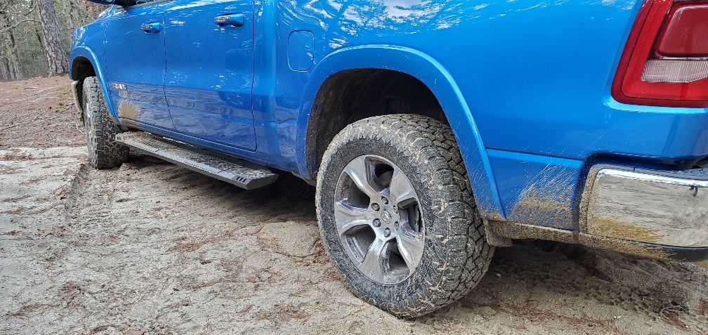

Here is an example of me going offroad, and the common dirty areas. I noticed that with the engine pushed back a little more, there is more room in the engine bay to get dirty.
