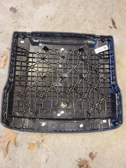

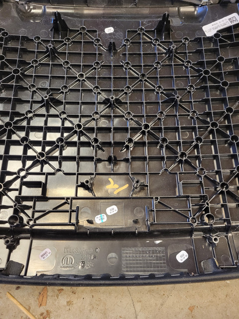

I wasnt sure if this topic goes here or interior. I also posted on the 5th gen facebook page but no help so far. Has anyone here PERSONALLY installed Katzkin leather? Ive got all the seats and doors done. Just need to do the center console lid. I cant find any video or instructions on getting this thing apart. Anyone help ? (19 bighorn crewcab full size center console - not a jump seat)
The cover on the underside pops off exposing the staples holding the cover fabric on. I believe it was 4 or 6 torx that hold the lid hinge and latch on. I have one pulled apart in the garage. I'll try to remember to grab a picture in the AM.

After removing the torx screws the cover just pops off with a trim tool.
Oh god help me theres staples? I assume the new will need stapled back on then. I wonder what size staple and type of gun Ill have to buy for this. Doubtful my sharpshooter for installing home insulation is going to staple into plastic.

Just these inserts. Theres a great how-to on youtube from leatherseats dot com .
