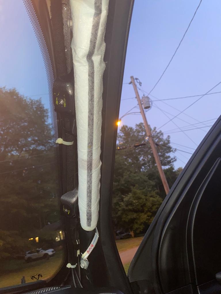

My viofo is hardwired through the A pilar to the fuse box, and the rear camera thought the passenger side headliner. I am not running parking mode right now, but I’ve had in the past w/o any sort of TPM issues.

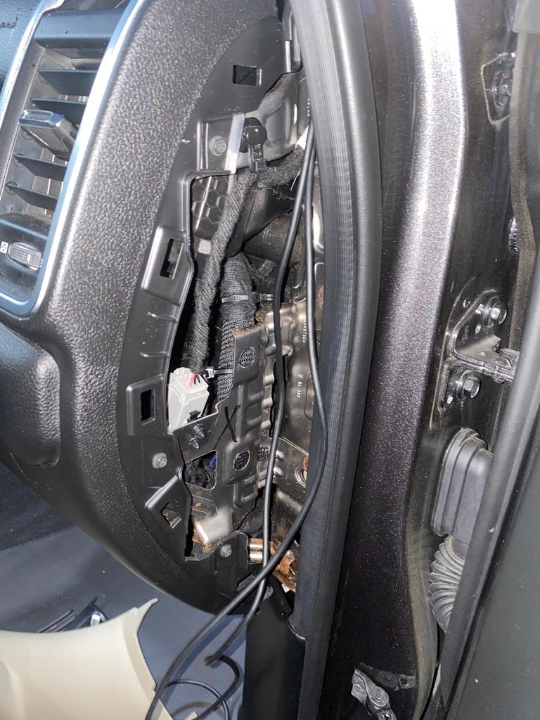

This my left side how it’s wired
I meant I need new places to tap into, instead of F33 and F66. I think I’ll go straight to battery for the red wire.
Well I’m tearing it out and don’t know what I’m going to try different have some rf blockers I’m going to put on the wires I’m not for sure if it’s the rear camera wire that’s causing it or the front camera wire I don’t think it’s the fuse taps though
