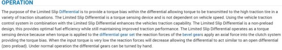

Or did i get ripped off? Ive had this truck 3 days and picked it because it was the only new ram i could afford with the anti spin diff.
Wheels be spinning opposite like...

It’s completely normal for that differential. Your anti-spin differential does not have preload springs. That is why it does that.

But im a little paranoid. How can i test/prove this?

when i change my tire, i notice mine did the same, on wheel spin in one way the other in a different way... and i have lsd like you,
my last ram, a 2014 did the exact.same.as well, also had the lsd
