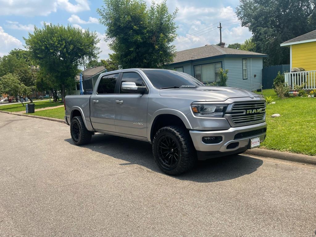

Bilstein 5100 front level with 33 tires and rides just like stock. Added hellwig sway bar and feels even better then stock.
Do you mind posting some pictures?

55

That looks great. That’s only bilstein’s up front?

Did you Notice a big hit on mileage? Is that on setting 5?
Not really. And 5 or 6 I forgot. I had someone install it for me. I told them just to make it as level as they could lol. I would do the same setup all over again.

Any chance you have a pic from the side? What size tires? Sorry for all the questions

Sorry should have been more clear, I was asking ever_garza.
