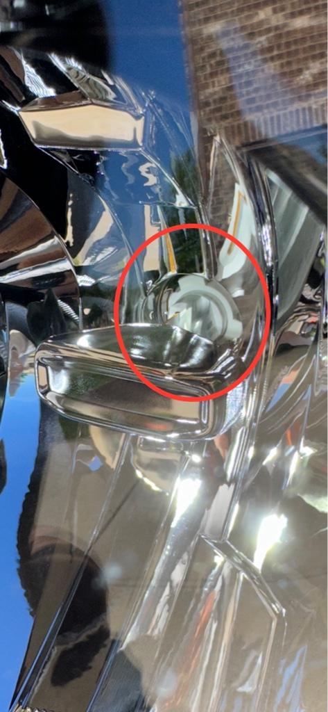

@Scram1500…looks like you were correct…I just took a look at the headlights and I can clearly see an LED bulb inserted into what appears to be the standard halogen socket…I also pulled the sticker from the truck and it specifies halogen headlights…so clearly the previous owner (or maybe the dealer) swapped out all the original halogen bulbs (front blinkers, front headlights, rear tail lights, even the license plate lights) with LEDs because this truck has LEDs everywhere.
So…I know you can use Alfa OBD (which I have) to tell the system that you have LEDs instead of halogen…I guess I’ll check later to see if those selections were made previously.
Im guessing it’s all the after market LEDs and the fact that they use less wattage than the OEM halogens thats’s causing my intermittent “front blinker bulb out” errors?
