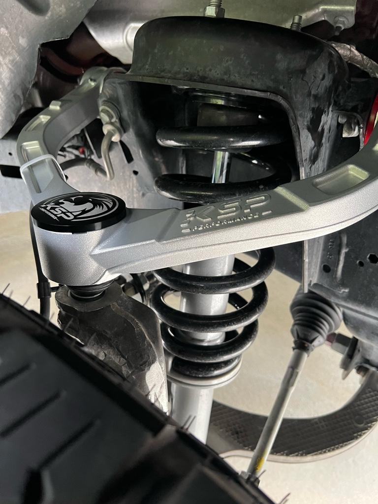

Ok perfect thank you so much yeah I was planning on getting the matching rears will see what happens. I did the struts and one of the uca’s were shot so replaced them for ksp upper control arms nice truck by the way.
Thanks man! I like the looks of those KSP’s. I went with the Mopar 2” UCA. Couldn’t resist the price as I got both of them for ~$120.
You can’t beat that I heard a lot of people going that route
