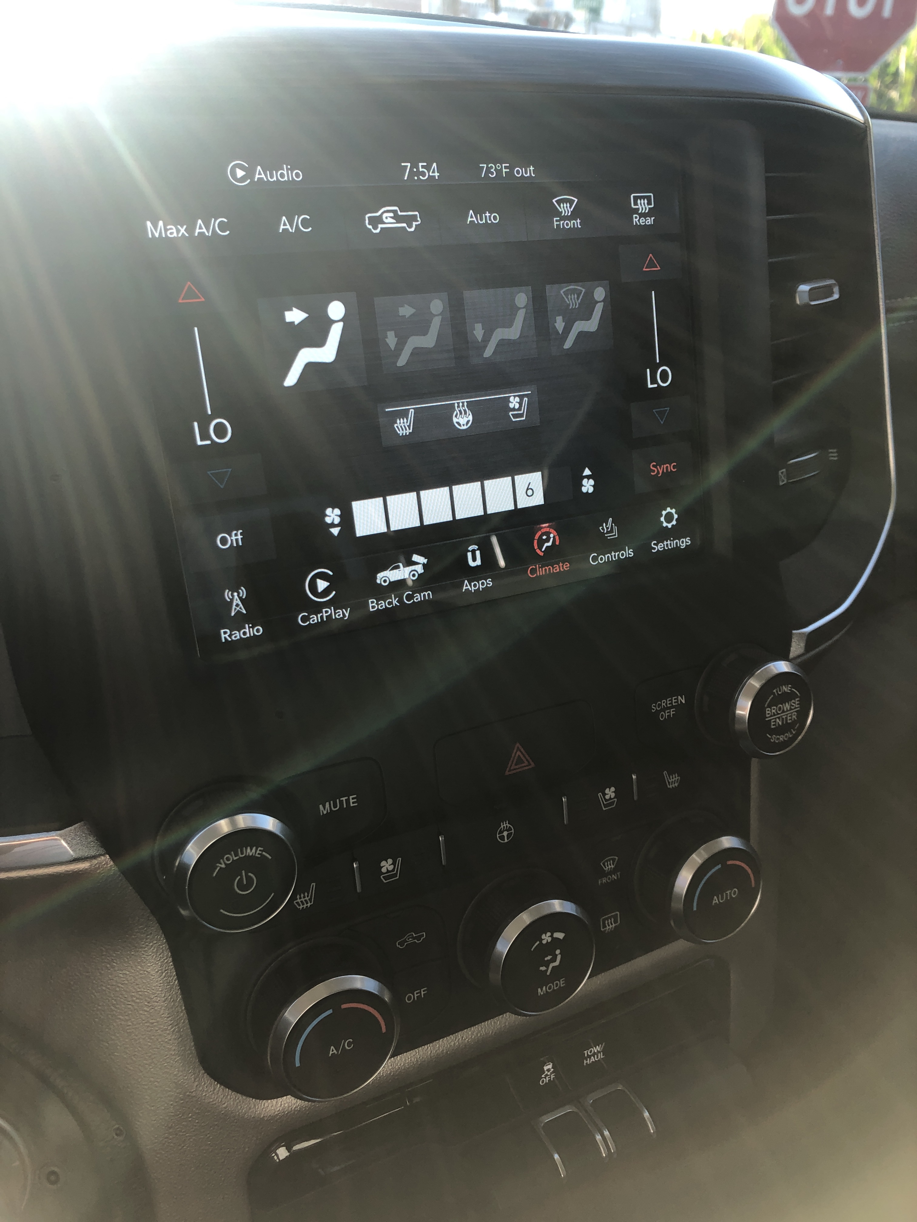

If you are talking about 'recirculate', that was off. Here is a pic of the settings. Should this be 'vent' mode?

Not sure then. This is mine on vent. Switched it over for the photo and the truck immediately started pulling outside air. No AC.

Thanks. That would be the same configuration. Would you mind switching it over and then leaving it on 'vent' for say 15 min and see what happens, if the compressor comes on?
On mine the compressor comes on 'periodically' (I've not done extensive testing as it only got cooler here recently where I would use the vent), it is not an 'instant on' or 'on all the time thing'. I called a dealer who blabbered something about 'that is normal so it does not get "Too Hot" ', which makes zero sense to me.
Ok tried it 30 min commute to work. 1. The compressor did not turn on under same settings. 2. The air coming through was warmer than the outside. Number two is odd never had a truck do that before. I’m guessing it’s a closed vent pulling from interior of truck. I don’t know. If the outside air is cold I expect the air being pulled into the truck via the fan should also be cold.
