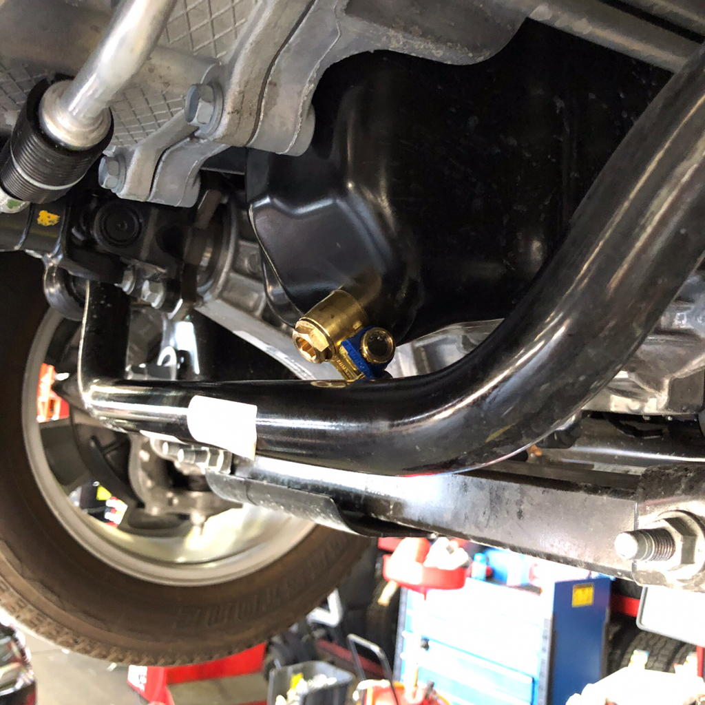

Get a Fumoto drain valve. They offer different variations. I’d recommend a Fumoto F-106S. Has a short nipple that you can attach a 3/8” hose to. $28.95 on their website.
The F-106SX is a better fit. I just installed it this weekend on its first oil change. The front sway bar is right in front of the drain plug and doesn’t leave a lot of room. ****ty design, the oil stream hits the bar and splash’s all over.
Glad you told me that. Doesn’t look like the sway bar would leave much room to attach thehose. I was just about to order the 106S...will be ordering the 106SX now.
Let me tell you...... I found out the hard way this weekend about that damn sway bar!!!! F-106SX is getting ordered right now.

I was planning to do it myself in the driveway but I needed a larger drain pan since the one I have is a 7 qt capacity. While heading to the store, I thought about it and decided see if a local shop could do it instead. I'm glad I did. They used a wide drain pan and it still splashed a bunch because of the sway bar. Also, the filter was on super tight. If I was doing it while laying on my back, I might not have had enough room for leverage. Now that the Fumoto valve is on and the filter only hand tight, I'll do them myself at home.
