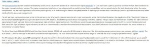

LF is white/green and RF is white/tan on 2019.
View attachment 174698 View attachment 174717
Thank you for the diagram and description. I've tapped the red power wire directly into my fuse box, and I grounded the black wire to the chassis. That controls the white "running" lights. Those look good and work perfectly. Then I tapped the yellow wire for the turn signal feature directly into the headlamp wiring harnesses via the white/green and white/tan wires. For some reason, the additional turn signals don't work! The light stays white instead of flashing amber. I know that they're getting a power signal because I used my voltage tester, and also when I hit the unlock button on my key fob, they flash amber along with my factory signals. But they only flash the first time that I hit the button. If I hit it multiple times, the added lights don't flash like the factory ones. It's almost like they had just enough stored power to flash once. Then nothing after that. I did not install relays because I'm unfamiliar with them. Do you think that could be my problem? If so, what type of relay should I use? Thanks to any and everyone for all of the help!
