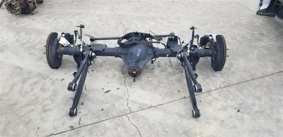

I have a 2021 ram that tows my open car trailer nicely but recently ive been looking at switching to a 24ft enclosed trailer thats about 1500lbs heavier, the truck is 1500 e-torque crew cab with 6'4 box and is 4x2 the chart I found states the tow capacity is 8,310lbs max trailer. The same fca chart states that the same config but with 3.92 gears is 11,410lbs, Id like the extra head room and better acceleration of the 3.92 gears how difficult is it to change the rear ratio?
Is it as simple as swap the rear axle out for a junkyard one with the 3.92 and change some things with alpha obd? is it possible to just change the ring and pinion or is that more hassle then its worth, are there different versions of the 3.92 axles from the junkyard I need to watch out for? If there is already a thread on this I missed please do share but I did see anything when I searched.

Would be better off to just have the ring and pinion replaced. Not sure about these trucks and having to program for the new gear ratio. I know it's an option with my TazerDT. On my older Dakota, the computer automatically adjusted for the gear ration using the speed sensors.
I’ve done ring and pinions before on ford 8.8s quite few times as it’s popular with drift cars. I just know some axles you can’t really switch the ring and pinions I didn’t know if it was able to be done on these trucks
They still use the Chrysler corporate 9.25 rear axle. Definitely doable. Have same basic axle in my 00 Dakota R/T that I had 4.10 gears installed in.

Only thing I can add is I bought my Rebel in great part because of the 3.92 gear ratio. Wakes the truck up and makes the A8 shine. Still gets 18mpg overall according to the EVIC (aka lie-o'meter).
Wish I knew more about if any other programming is involved or if speed (and speedometer) come from wheel sensors rather than the transmission.
