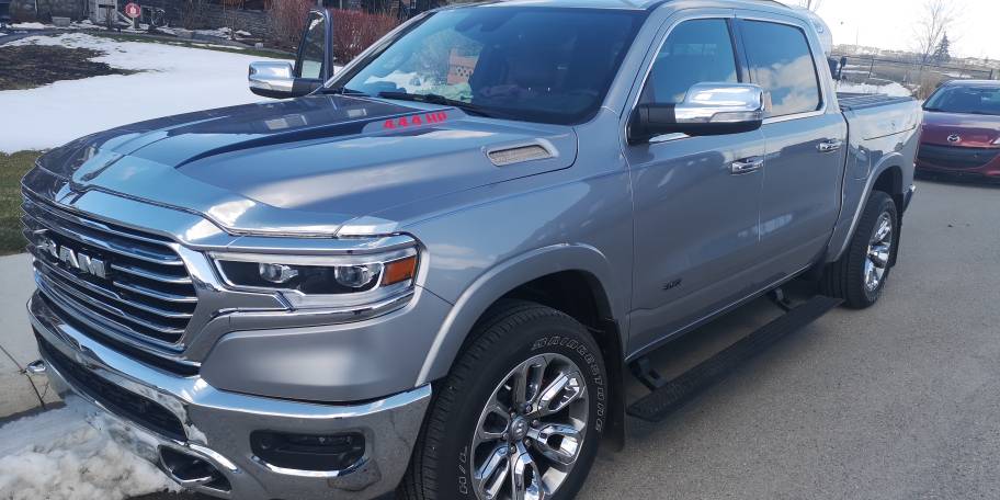

I've done it. Very easy, just use a plastic tool (trim removal tool works great) and get behind a corner and pry up tab at a time.
If you look at pictures of the back of the insert you can see where the tabs are and how they lock into the hood.
I have the black inserts and then put the red stickers on.
