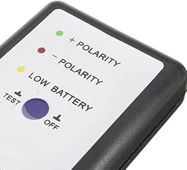

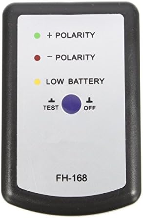

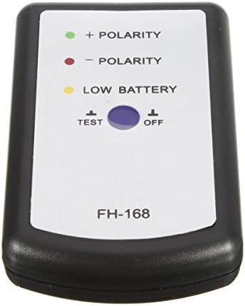

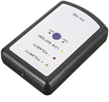

Warmer. Not as sharp. Don’t trust the stock polarity. Amazon
Brand: Actopus
4.0 out of 5 stars29Reviews
Actopus Speaker Phase Meter Polarity Tester PH Phasemeter for Auto Car Audio​
  1. Actopus Speaker Phase Meter Polarity Tester PH Phasemeter for Auto Car Audio
$22.99$22.99
& FREE Returns
