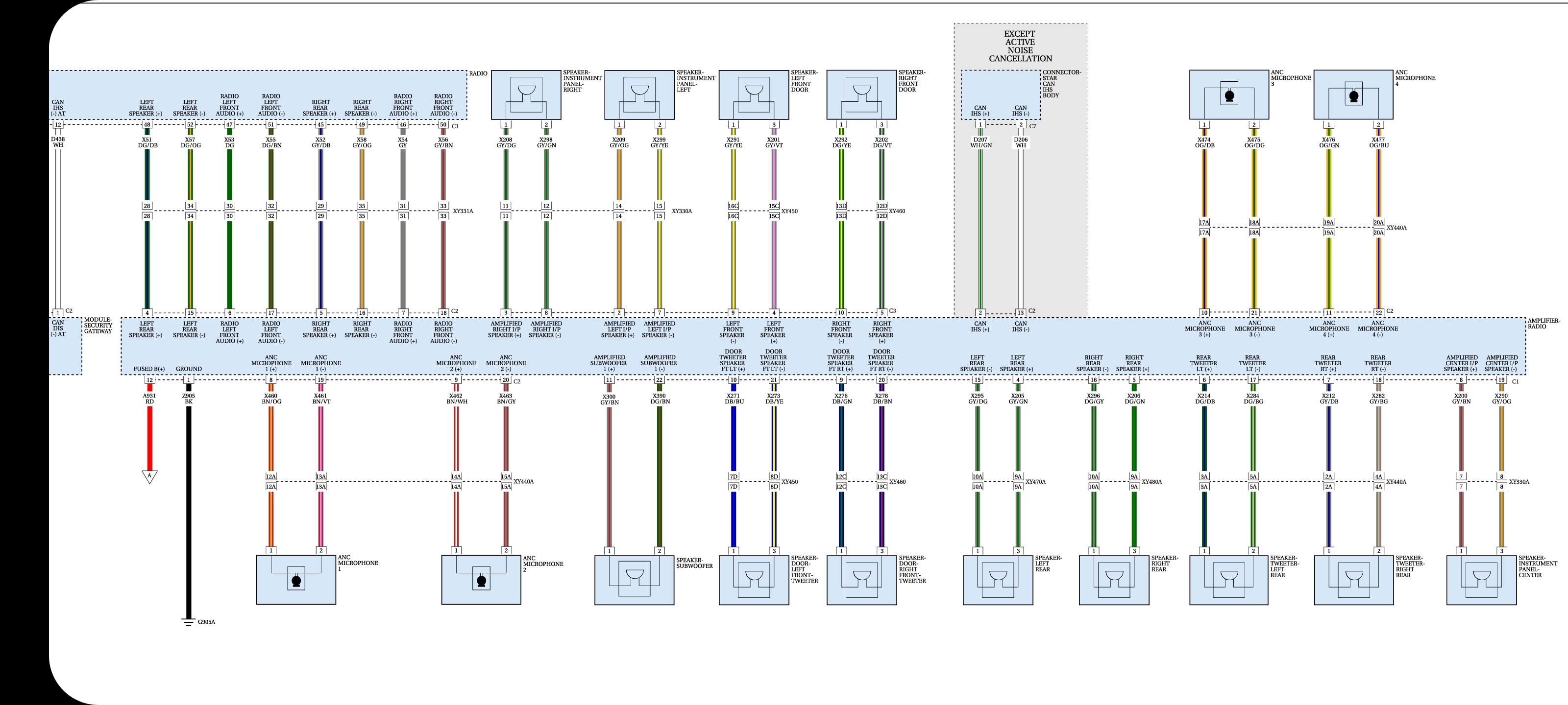

On both the hk and alpine system, every speaker has its own channel and is crossed over at the amp.
Not sure who I got these diagrams from, but props go to them.
This pic is the hk.

Only mid bass is sent to the woofers, you won’t fully benefit from two or three way speakers in those locations without adding an aftermarket crossover/amp setup to send full signal to them.
Overall the factory 6x9’s didn’t look all that bad when I replaced mine with infinity 3-ways before knowing they only receive mid bass from the amp. The door tweeters are on a separate channel, you might have to do some modifications to the door panel to get something with a bigger magnet to fit.

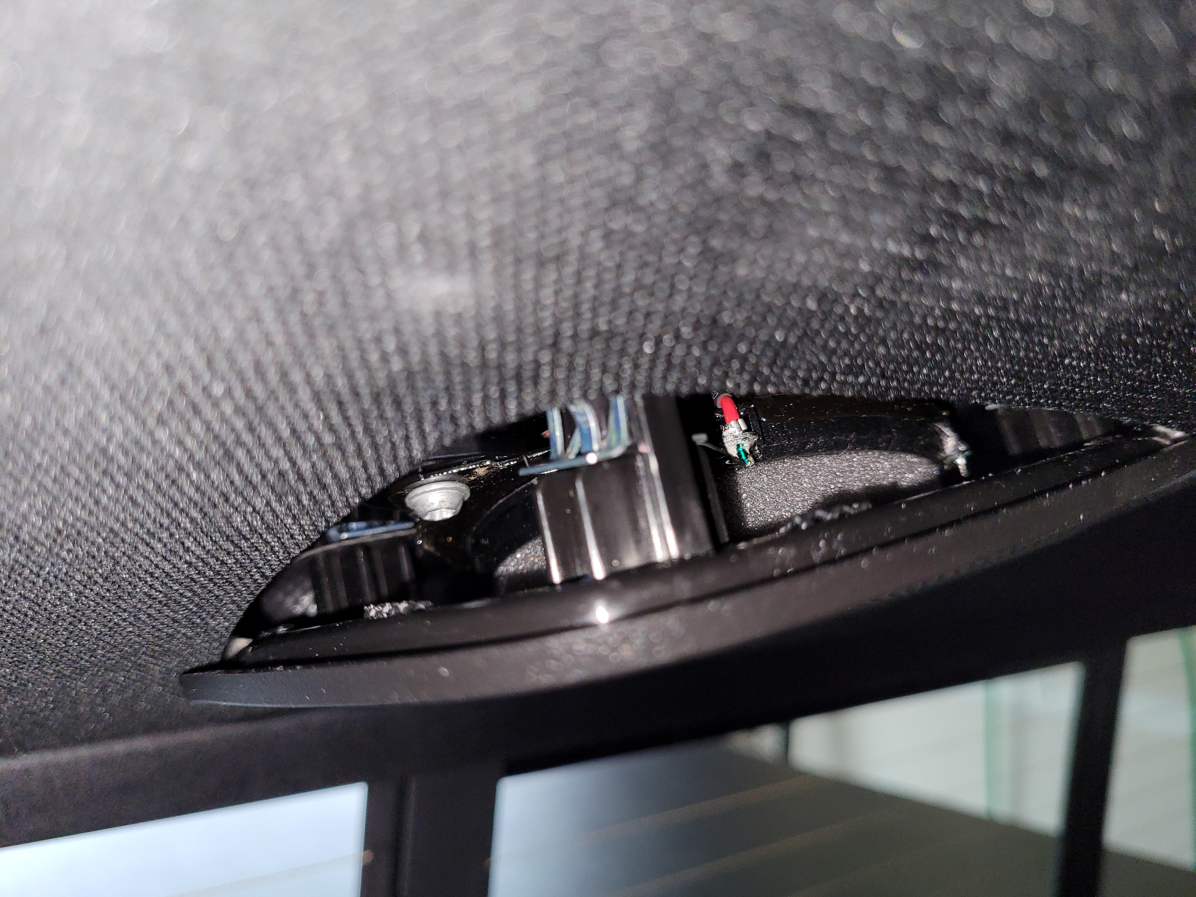

Can someone PLEASE tell me how I remove the headliner speakers? Unless removing the entire headliner is the only way… ?
