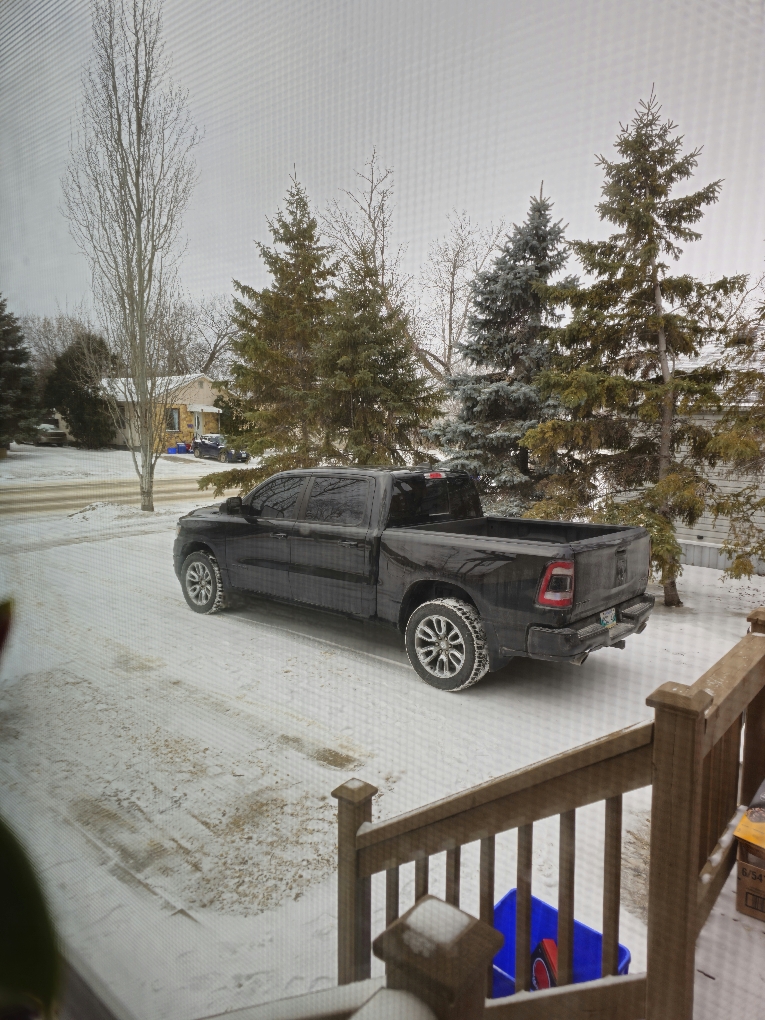

Hey guys looking for some input for my 19 sport. Going be putting on bilstein 5100's set at 2,2" with aftermarket UCA for a 2" level from ready lift. I have stock rims and would like to keep them. Not certain what offset they would be weather they're a +1 or 0 etc
Question is looking to run a 33 any specific width I'd be ok with ? Is a 12.5 to wide that would cause rubbing ? Thanks

12.5 may rub. 11.5 would definitely be safe.

I ended up grabbing some 20x9s with a 0 offset. Think that would make it certain to not rub the UCAs with the 33x12.5s?

With the lift, I would say that you're safe to ride! Shouldn't be any rubbing or scrubbing either. When in doubt, Custom Offsets has a spectacular gallery with images and references that are vehicle specific.

Stock rims are generally +19.
