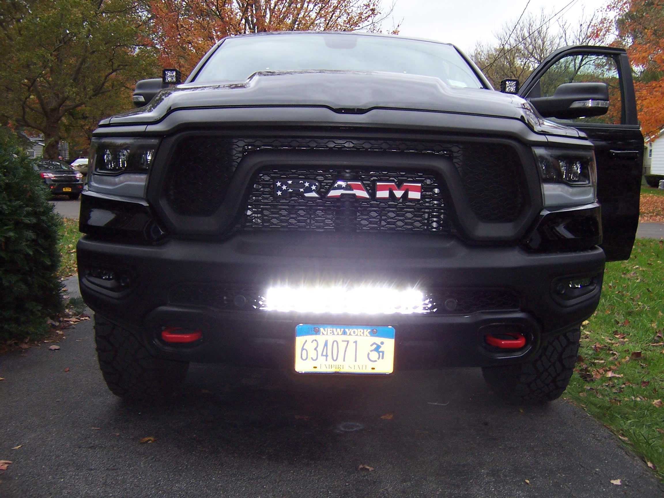

If you look at the fuse box under the hood look for the 5 posts(stud) with nuts on them(take the fuse box cover off and you can see them). The second one from the firewall doesn't have anything attached to it. You can use this one. I used it for my Rigid lightbar and my remote switch. Only comes on in Acc or Run.

Oh wow really, ok I'll try them out. I saw other people say to use the second post but assumed it was an always on one. Thanks
