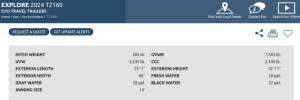

Load Stickers on trailers I've owned include actual GVWR and CCC, but not tongue weight. So you have to go find out by finding the specifications of a trailer from the RV Manufacturers. Using (say) a Forest River T2160 as an example, this is a 25' trailer with a hitch (tongue) weight of 585 pounds:
At 7,585 GVWR, I would feel more comfortable towing this longer distances with a W/D hitch with a 1500, but not on the ball. Popular hitch brands you see mentioned frequently are Blue Ox and Equal-i-zer. I have personal experience with Equal-i-zer; it works well.
Continuing the example, adding the 86# of the hitch to the TW listed (585#), you are now at 671# payload. Your cargo on board you said was 650#. So load on the truck adds up to 1,321#; within your truck's max payload of 1,465#.
(By the way, one other wild card is water. At around 8# per gallon, a full tank of 50 gallons in this rig would be 400#. Opinions vary about running with full tanks vs. empty; full can make the rig feel more "settled" but you do have to haul it, so mpg is reduced if you top up all the way. I could tell full vs empty going down road. Having "some" water on board is valuable, but I didn't run mine 100% most of the time, because our style was at parks where we plugged in, mostly. We didn't boondock a lot.)
There are a couple other figures worth checking (e.g. GCWR, GAWR) before making a final decision. And ideally you want to run the rig over a set of CAT scales to verify the load is properly distributed (or ballpark it with the Front Axle Load Restoration method the Ram manual provides).
As regards changing springs or adding air bags, I'm not qualified to common on that, and would defer to someone with experience in adjusting the truck with aftermarket parts.
But like I said, this should put you in the region what you can expect to tow with your truck, as it is now.

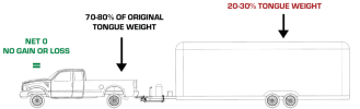

With the weight distribution hitch, you are now seeing 70-80% of the original tongue weight on the back axle of the vehicle while that initial 20-30% (that was lifted off the front and added to the vehicle’s back axles) is now applied to the trailer axles.
Well, look a there. Didn’t know that.
Good to know.
Ramroo
Jul 1, 2018
779
1,151
It's all about leverage.
Yea when I first starting using a EDH towing heavy equipment with HDs I had convinced myself that the hitch didn’t help much with payload / GVWR limits. I only weighed several times, but I transfered more weight to the front axle ( as opposed to your diagram / bringing back to original weight). That, and the additional weight of hitch I thought it was a wash. I wasn’t counting pounds too much like y’all pulling TTs with 1/2 tons.
Definitely use one.
Leverage of the bars removes weight from the rear axle, and redistributes it to the trailer and front axle. Don't know why they don't show it that way, but the important thing is that it reduces the rear axle load.
Ramroo
Jul 1, 2018
779
1,151
Yea I get that.
My point was that I distributed more to front axle (than diagram) than to trailer. Thus not helping as much with GVWR.
I saw that is an option of moving a much higher percentage of tongue weight to trailer to help with payload /GVWR limits, but was not my issue with the HD. Got axle limits also.
My whole point of even mentioning it was my recommendation for OP to not count on WDH to help with payload limits IMO. Like you or someone else said, you always have more weight in truck than you count on.

Yea I get that.
Yes, GVWR will never change. It is what it is. But as long as a needed tongue weight is maintained for stability, a certain amount of weight can be positioned when loading the trailer, along with WDH to maintain adequate tongue weight. If that can't be achieved, then a 3500 or a smaller trailer.
