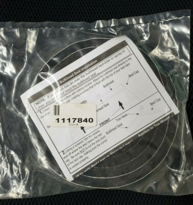

Check this out
It has double sided tape on the bottom, and it's like a foam rigid piece. You can put it at the back and the rubber piece at the end rests on this
It looks like water is seeping through the very ends on the sides because the seal doesn't go all the way
I also see a TruXedo Replacement Bulkhead Seal, which looks pretty similar but appears to be a softer lower density foam
To confirm this on a hot sunny day when it's completely dry, take a garden hose on low pressure and spray the top of the cover in very small areas and see where it might come in. When you think you know where it's coming from test the other side to confirm.
I think it's the spots I marked on your pictures.
You can use foam or silicone to seal it and trim any excess silicone.
