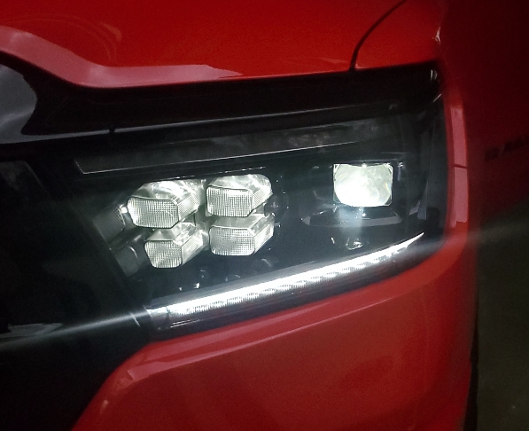

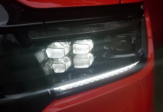

I did a test and the DLRs are always on, but in different states when the toggle is switched on/off.
The first pic shows the DLRs in the off position, obviously not off. The second pic show DRLs toggled on, it seems to turn the headlights on. The rear lights stay off.
Hi Ironox, did you install the fusetap for the optional DRL function on those lights? My 2020 Bighorn has the function in the Uconnect to turn DRL on or off so I'm wondering if you have to wire up this feature of the Morimotos if it should come on when you plug the lights to the factory wiring hareness.
I spoke with Morimoto (Headlight Revolution), the DRLs are designed to come on with the ignition. I was told the DRLs could be turned off if a jump wire and switch were installed.
In other words they didn't take the UConnect DRL function into account.
