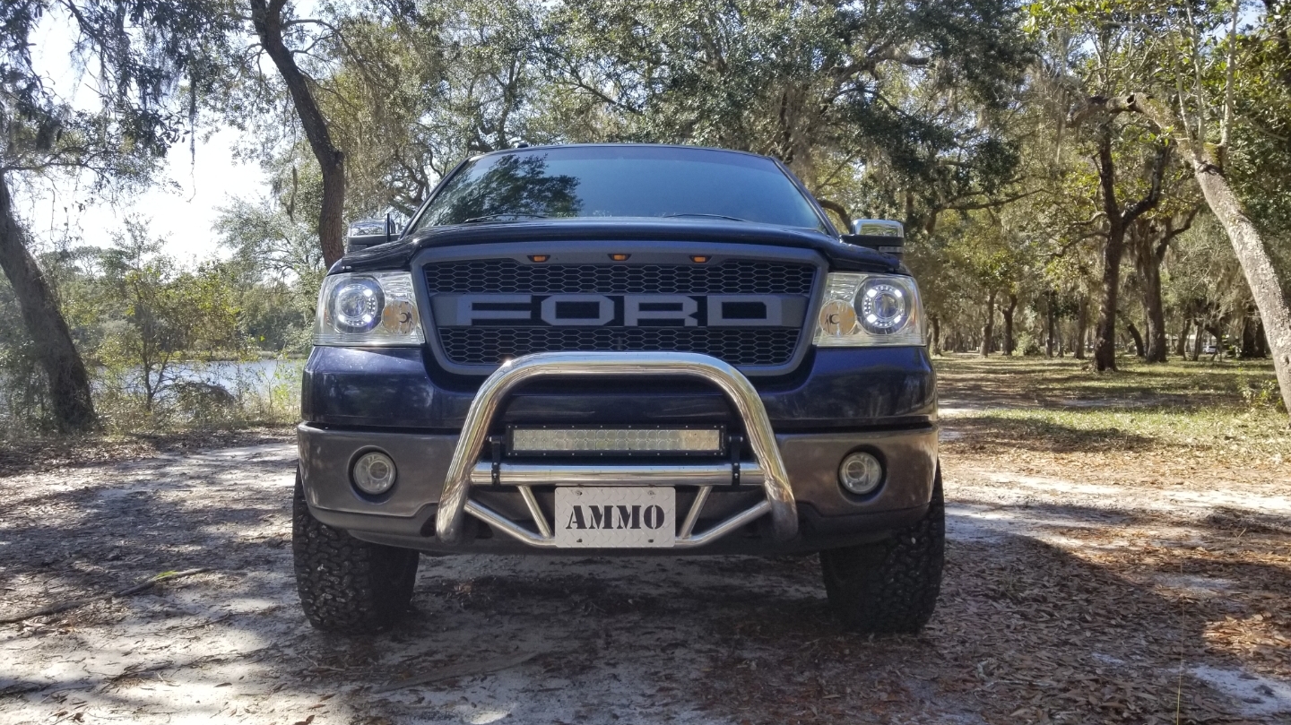

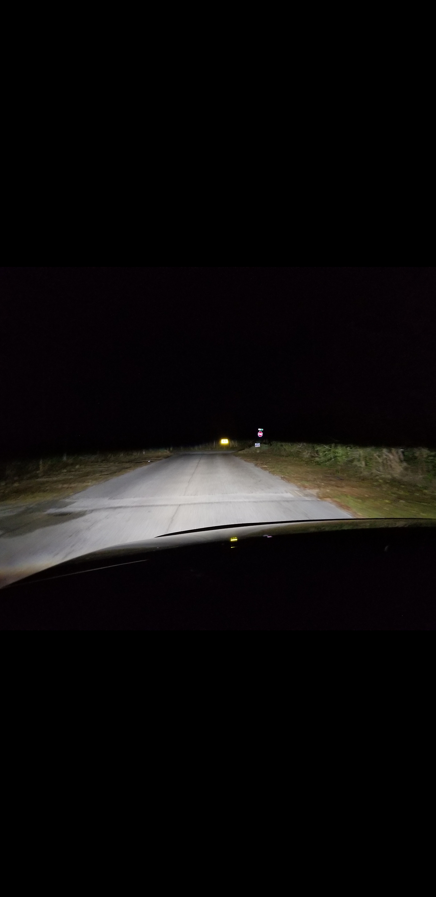

If I had the halogens, I'd do a custom retrofit. They seem intimidating, but the hardest part to most retros is separating the housing. Pick a big shroud that fills the factory reflectors and it'll look good and perform great.
I did my 11 ram and my 06 F-150.
