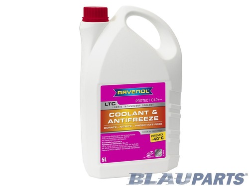

That's very true today. It seems the product could get a new number based on a change of manufacturer but usually you can make a connection with "superseded by", related search, forums and such.
I believe this is the only one I could find that met the owner's manual specs:
I just realized that your manual actually did put the part number of the coolant concentrate in it. So I guess my theory was wrong.
Prestone dexcool in their specs says they meet both OAT and HOAT. Here’s the version I’m talking about:
