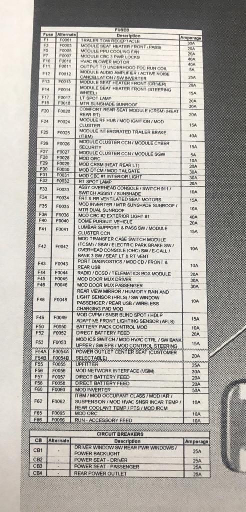

I’m looking for a little help. I am trying to find a fuse location in the fuse box under the hood, one that is on when the truck is in accessory mode or running.
I am looking to tap the fuse location to trigger a relay so I can power my air compressor. I want to run a triggered relay so the compressor does not have power all the time.

Fuses - Constant 12V is F33, switched 12V is F66.
F66 and f34 or f33 is the ignition

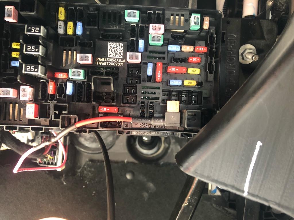

Thank you! I will have a look tomorrow. Are these locations under the hood or at the BCM under the dash?
Thank you! I will have a look tomorrow. Are these 3 locations under the hood or at the BCM under the dash?
yes under hood kick panel need two screws to remove kick panel Fuses - Constant 12V is F33, switched 12V is F66.
I was unaware of this location, do you have a picture of where I should be looking?
Thanks guys! I appreciate all the help and input.
I got it all figured out this afternoon and wired up. Location F66 works great for triggering the air compressor relay.
