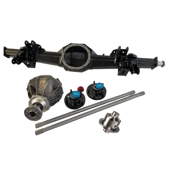

Hey BigJeff. I know this is an old thread, but I actually imported one of JMacx's Ford 9" rear axle for my DS Ram 1500 last year. I wanted to gain a little peace of mind while towing my travel trailer as it related to payload. I also upgraded the factory rear airbags, wheels and tires to match the capacity of the rear axle. It's been nearly a year and no issues. I have a 2016 Ecodiesel and it's my daily. My travel trailer is only 7300 lbs max and well within my Ecodiesel's towing capacity, but the tongue weight ate up all my payload. Installation was truly plug and play mechanically with the axle. I did end up installing an air compressor for the ARB air locker.

It was about 14k. 10k for the axle and 4k for importing. Seems like the OP was looking for folks who might be interested in buying together to potentially get a better price on importing costs.

how does it ride, do you have more pics ?what year is your truck?

JMACX indeed makes a rear axle for the DT. Watch their videos on youtube. They go into detail on the wheel bearing differences.

Ride is great. As people mentioned, it is unsprung weight. What did take a little hit was the fuel economy but not by much. I still achieve up to 17 mpg on flat roads while towing my TT.
What I truly gained with the axle is additional peace of mind. Pulling a travel trailer hundreds of miles from home can be unnerving with the thought of something going wrong. With the axle upgrade I now don't stress about the health of the wheel bearings. Another benefit is the ease of maintenance on the wheel bearings. I changed the bearings on the factory axle once and pulling the bearings out was a pain even using the factory recommended tools. On the new axle, removing the bearings for either repacking or replacing is really easy.
