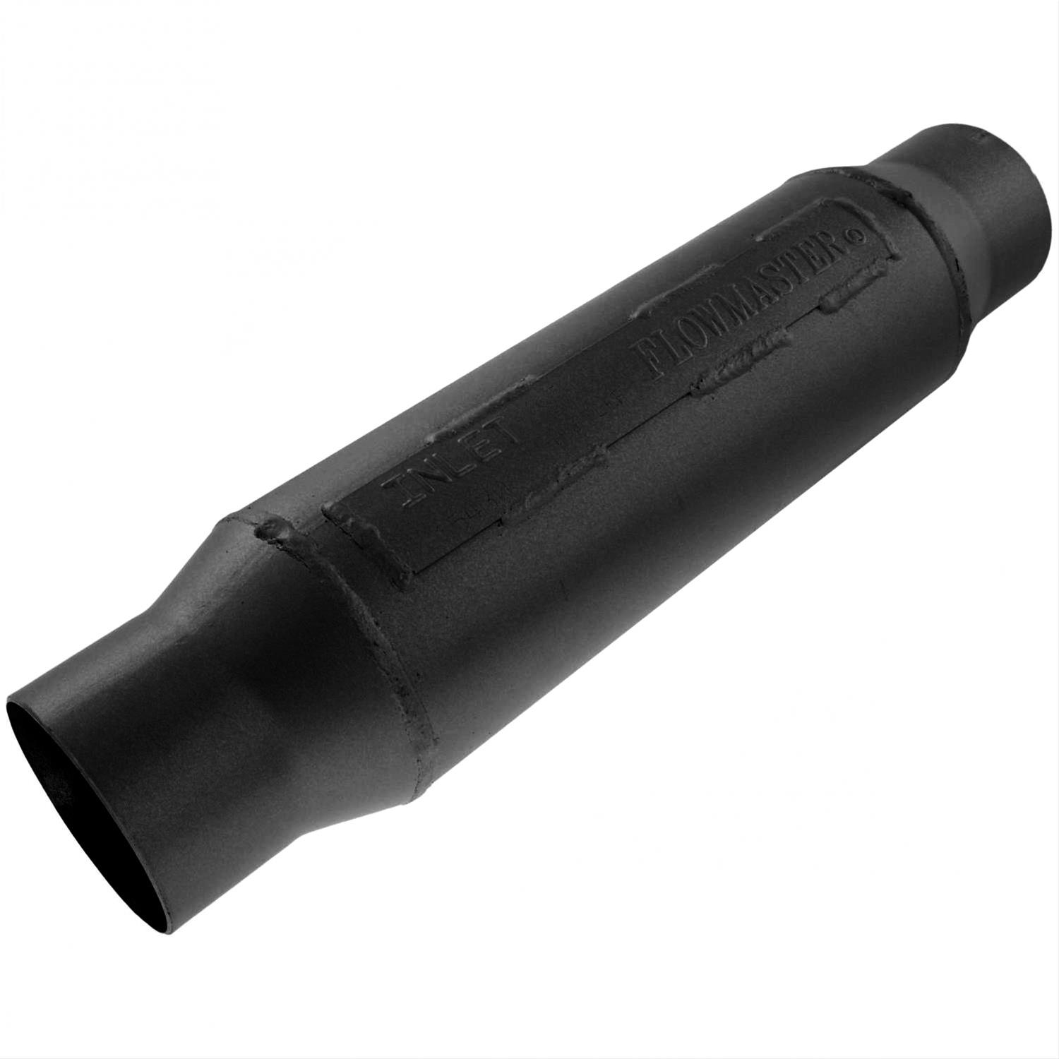

Actually, the muffler shop that did the install already had them in stock, but here is the one that's on my truck...
Here is the shorty version, which is likely louder...
