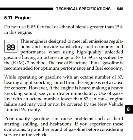

traded in 2014 ram for this. so far i love my truck, seems to like 89 better than the 87 sounds like a diesel when i run 87..anyways ive

turn fog lights on and it will eliminate that feature. using 87 definitely shouldn't make it ping/detonation must have some **** gas up there...
Actually, from the manual:
"While operating on gasoline with an octane number of 87,hearing a light knocking sound from the engine is not a causefor concern. However, if the engine is heard making a heavy
knocking sound, see your dealer immediately. Use of gaso-line with an octane number lower than 87 can cause enginefailure and may void or not be covered by the New VehicleLimited Warranty."
