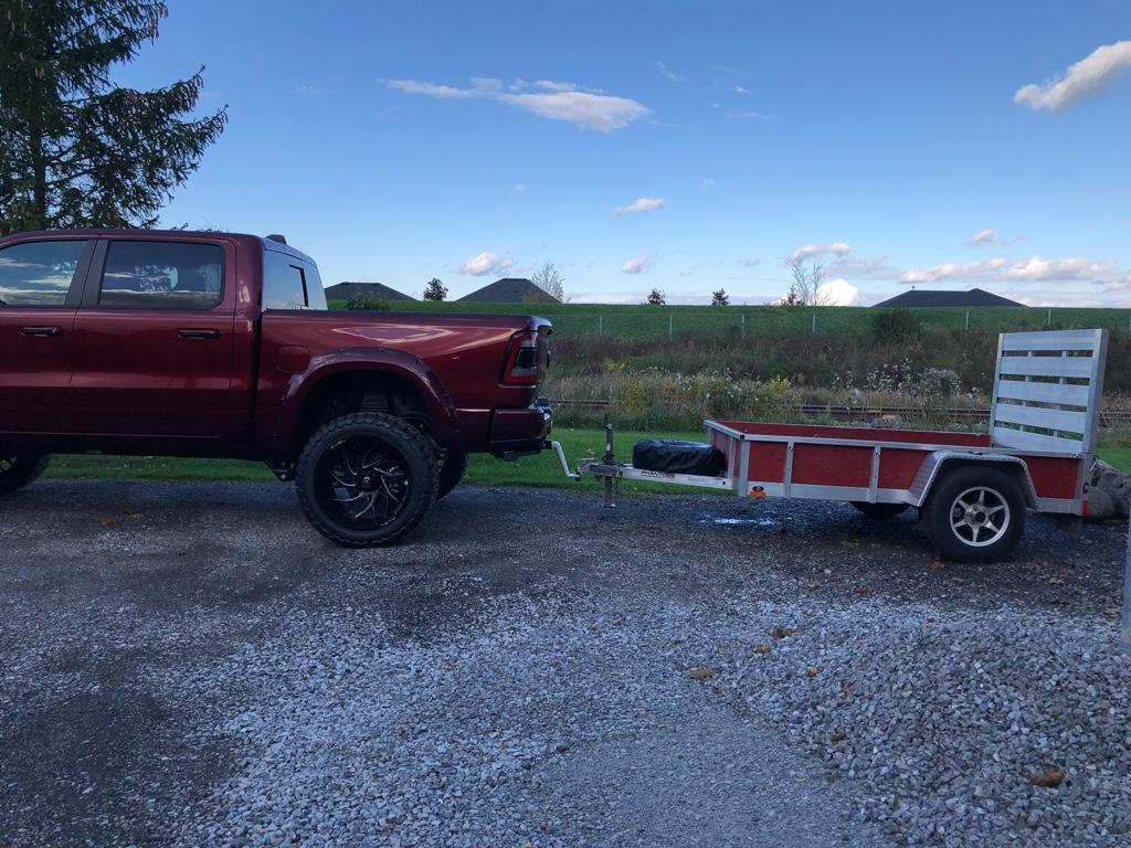

Anyone wanting to put big tires on of this caliber will be needing an 8” total lift. The problems start when you choose 12 wide opposed to 10. You can fit 37x12.5 with a 10 wide wheel on a basic 6” suspension lift but you’ll need to do a 2” body lift to fit the 13.5 wide 12 wide rim -44 offset. After doing so the clearance at turn is 3/8” off the painted front bumper. They don’t offer an 8” suspension lift yet for the ram 1500 and I’ve seen a couple modified 6” pro comp converted to 8” but the geometry is drastic looking. I know everyone bashes body lifts but I have no regrets! It looks great, dodge takes them very well no body gaps or anything just need to offset exhaust tips back up. Also need the calibration module for your speedometer and odometer. But all said and done ZERO rubbing even at full turn. Steering radius is less of course but who cares lol and it’s not that bad at all. Turn this girl into a beast! And I’m so pleased

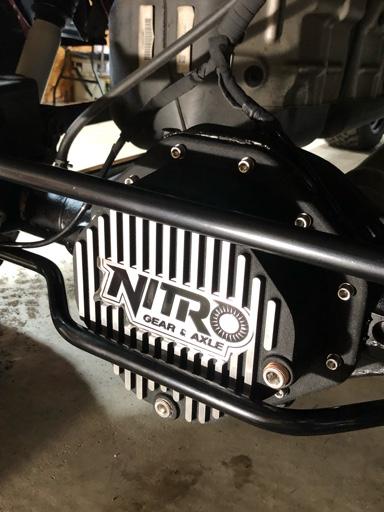

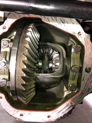

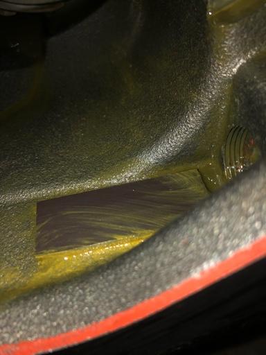

Trucks holding up great! I do some mild towing, with a utility trailer. And haul my 1025R diesel JD with it. Just put a new differential cap on and the oil was clean. Magnetic pad was clean. I’m so happy with it
