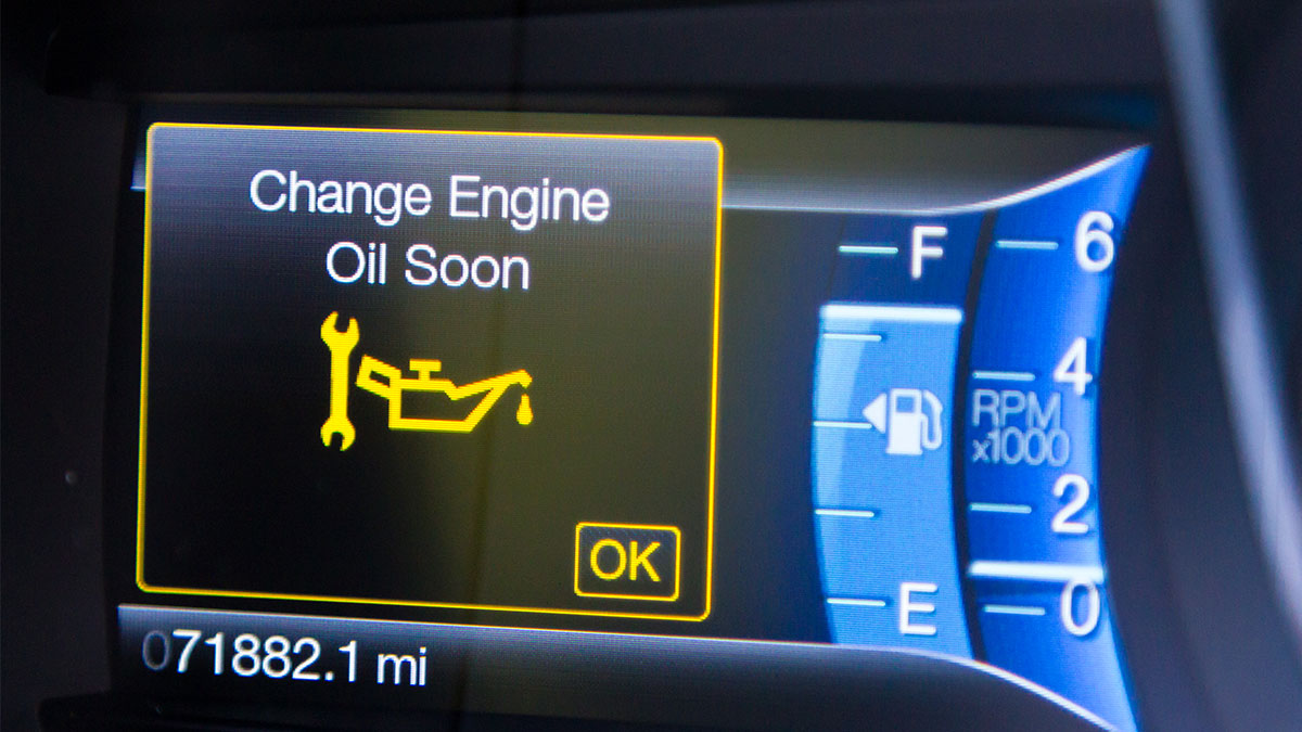

I've read through some of the threads and seeing different opinions. I bought my truck in 01/2021 and it has 3,800 miles with 230 engine hours, most miles are city. I live in Florida and temps are in the 90's now. Owner's manual refers to oil change indicator system, but not sure what or how this displays as the manual does not state this. I have the base instrument panel as well. I called the Dealer and got two different answers, one said wait for the Oil change indicator to display and the other stated 5,000 miles. I'm thinking change at 4,000 miles due to the heat and city miles. Concerned about this so if anyone has input I would appreciate comments.
It took me some time to set up my instrument panel the way I like it. I have the oil life % on my display. I'd be surprised if you are unable to do this.

I appreciate your response Jako, and thanks for the link for more information. Forgot to mention but my oil life is 43%, but I think it's time to change the oil now.
I use penzoil platinum and change every 5-6000 miles. Most my miles are hwy as I travel for work. My indicator is usually at about 25% if I recall correctly. I have 15000 miles on truck and it's only 10 months old. About to do my 3rd change. I just try to stick to 5 or 6K regardless of indicator %.
I would just change it, especially for your first one. Regardless of mileage or indicator, do not go beyond 1 year if you want to keep your power train warranty.
I did my first change at 7500 miles. After that I've changed it when the oil life % gets to 5% or less.
I know that the oil life "calculator" takes other factors into consideration besides miles driven but I drive about 20k miles/year so I'm pretty much on the 10K mile plan for oil changes.
You will get plenty of opinions and differing answers but I use a good full synthetic every oil change (Pennzoil Ultra Plantinum - which is different than Pennzoil Platinum) and go 'the distance' of about 10K for my oil change interval.

For me, the oil life indicator tracks the odometer, aiming for a 10k change.
I thought that as well but apparently there are other variables it considers as well.
I drive a lot with minimal idle time so mine pretty much tracks the odometer too.
These aren't from any official corporate website (and I don't endorse any of the resources) but they give some good info on what the oil life monitor is/does in these newer vehicles:
I don't claim any knowledge to how the oil life meter works but the truck tracks idle time too. It is a setting in the cluster. Only other vehicle I had that did that was a P71 Crown Vic.
Right. I’m sure there’s more too it, but like you, observed behavior for my driving (including towing) is linear.
