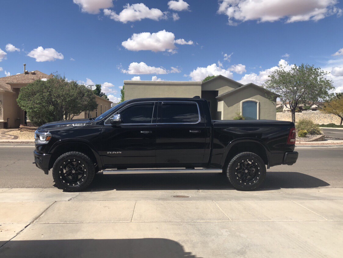

Do you have any pictures of the finished product?

I have the Mopar 2” Lift with the updated Spacer. Also added the ORP springs. Just put it on last week.

I went with new wheels and tires. I had it on the stock setup but to me it didn’t look right.
Falken Wildpeak AT3 305/55/20
20x10 -19 Offest Wheels
