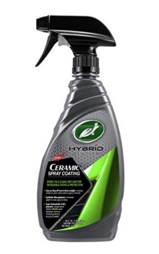

Superfine clay bar, polish, then wax or ceramic … For the price, I can’t say enough good things about the stuff below …. Check out the Youtube testing and reviews

Agreed! When I bought my new Ram a few weeks ago, my first order of business was glaze, wax, ten topped with a layer of this stuff. I'm not a believer in the expensive ceramics as none of them are going to protect as long as they claim. Spray ceramics provide a lot of shine and protection for a small fraction of the price. And the Turtle Wax spray is better than most.
Thanks. This is available locally. Is it necessary to clay bar first? If so how long of a process is it to clay a Ram?
It isn't typically necessary to clay a new vehicle depending on how far you've driven it. Clay gets rid of road and weather contaminants you can feel, but can't see. A great way to tell for sure is the plastic baggie test. Put your hand in a plastic baggie and feel various areas of the paint after a fresh wash. If you feel anything not smooth - it's time to clay.

Do your research on ceramic coating before you go out and just apply one.
There are different types for different expectations from each product. That turtle wax one is basically just something that will make the truck hydrophobic and protect against uv. A better coating will help with microscratches and swirling.

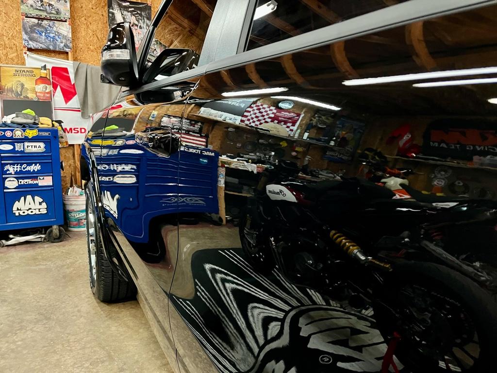

This is my stuff after Avalon king ceramic coat
There are better/more expensive options. But the quality to cost to ease of application ratio works for me.

No paint correction on my ram, straight from the dealer, to clay bar, coating.
I’ll take a pic of it later today. I just washed it after a big snow storm and still looks like that vid.

You have encouraged me to try the clay kit. Not a big deal if I have to break it up into sessions. Your truck and Indian look great. Thanks.

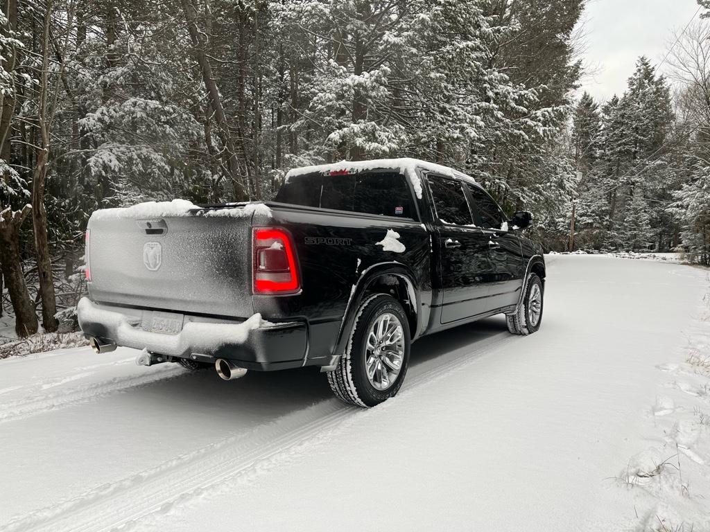

Before and after the weekend. Just ran it though a touch less car wash then wiped it down with some quick detailer. Not much sticks to it
