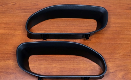

Lots of good info here. One more thing to add...don't forget the tow hook bezel covers for the bumper if your rig didn't come with tow hooks from the factory

So I'm reading, good info and friendly people looking to answer and help out wherever they can. I was able to get a set of those in the above picture so should be all set now.

Older thread I know, but I'm doing this now. The tow hook bezels I have don't have those little nubs on the bottom, they have slots like the top. Anyone else have this? Should I get some of the bolts that hold the top in place to also use in the bottom? Also, does anyone know what size the shorter bolt is that holds on the tow hooks. I bought some hooks to install, but I don't have the shorter bolt.
IIRC my blanks had the little bolts and clips on them, and I transferred them to the tow hook bezels. If they've revised the parts, YMMV.
The short bolts I used were 6508668AA M14x2.00x45, which Ram's website said won't fit my truck but do. As opposed to the ones they said would fit but don't.

I ordered the OEM bezels and they had the nubs, and the same with the short bolts for the tow hooks, got OEM and they fit perfectly.
