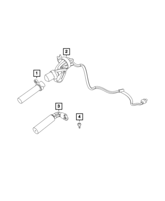

Just an FYI for people out there. my 2021 EcoDiesel has the Mopar Cabled hooked up to it (part number - 68357826AA) that I did myself. Mine came with the heater but not the cord and the official Mopar part is a much tighter fit with built in connectors that I liked much more than the stuff I was finding on eBay.
Anyway, I run a system that monitors energy usage. When I plug in the heater, my electric usage jumped from 550 watts to 1000 watts. I did this a few times and it was consistent. So the engine block heater pulls 450 watts when going (about like running a heated blanket)
