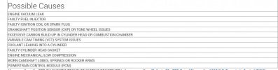

So I have a 2020 Ram Rebel I purchased a while back. I bought it used with the remainder of factory warranty. That warranty is passed and now I'm getting a misfire on cylinder 6. Through process of elimination I believe it's issue is coming from the control. What I don't know is, is it the PCM or the ECM that controls firing sequence?
Note* I'm clearly not a mechanic but just looking for some help figuring this out.

Yessir, moved the coil and spark plug. The wire ohms out correctly as well. Still reported the misfire on cylinder 6. 😕
