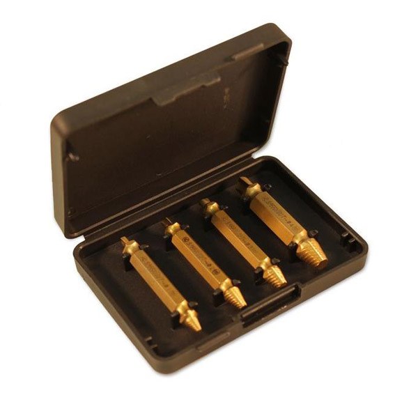

Lol, I have those for house and grade 2 bolts, and I haven’t had one break yet. Now that I see that, I’ll probably break one tomorrow.
They work good, only problem is they are double sided, so you gota be careful putting them in your drill.
I got them from the as seen on TV store in Foxwoods or Mohegan I forget.
I have a set from China that are like regular bits and work great too.
