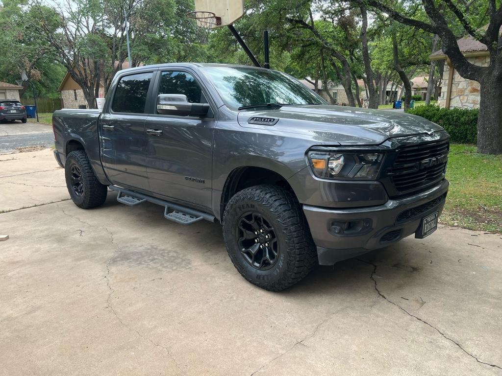

2021 ram big horn with 2” level and 1.5 spacers

Is the 1.5 spacers I used no trimming of stud
Level kit was motofab 2” and yes it will rub had to get a hammer and bend a metal bracket where there is a push fastener at the bottom and used a hair blower to mold the liner front and back of the front wheels will rub only when hard turn. I still get a quick rub every once in a while ride quality is great very little road noise gas I really haven’t noticed since I also have a pedal monster which improves the acceleration a lot so don’t know if that also affects gas mileage. I also got a 5 trx rim and tire when I bought this set so I’m trying to see how I could put that in spares place. There someone on that has done it already so will try later.

Installed with a 2" spacer lift, the tires were rubbing the upper control arm very bad when it was lifted on the lift, drove it to the nearest shop and bought a 2" spacer which is an over kill but at that time that's what's available.
I will update you on pictures in a while
I can’t edit the previous post but this is my truck with 2” spacer.

Got a project coming up this week with a 2023 Bighorn without ORP, installing Bilstein 6112s with Icon UCA’s, and the 5160’s in the rear and the TRX wheels and tires. Will update with photos along the way and before and afters.
Finally got around to it, installed Bilstein 6112s up front, Bilstein 5160s in the rear, Icon UCAs, and TRX wheels and tires. 6112s are on clip #7. 1.5” hubcentric spacer in place and everything fits. Minor trimming up front to the inner fender liner but now achieved zero rub even at full turn. Enjoy, hope you like the truck and I’ve got a lot more coming.
