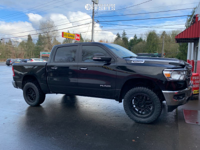

I have the TRX wheels on my big horn 2022, i installed a rough country 3.5” lift kit with new front/rear shocks, and new front arms, i needed a 1.5” spacers too

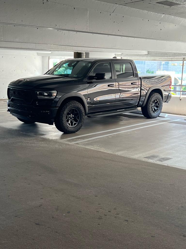

Just mounted a set of TRX takeoffs with new DuraTrac 285/75 tires to my stock 2019 Rebel. Tires fit perfect with zero rub anywhere. Truck is stock with no level, coil springs. Space between UCA is enough to get a finger through.
