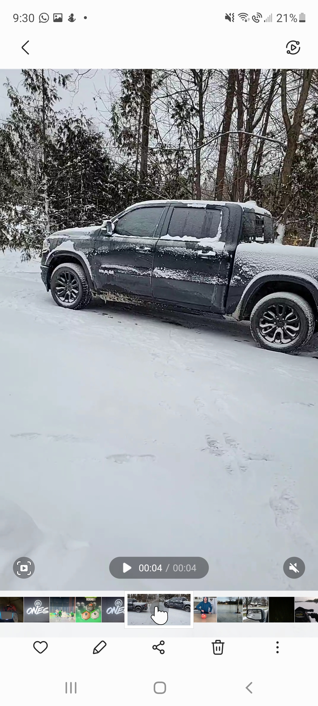

-29C = -20F
That had to be a treated fuel that you had.
Likely your truck was in a heated garage also.
Straight from the pump. I'm in Canada. I don't add anything to my fuel and my truck sits outside 24/7.
straight from the pump, it was treated or you would have had problems.
It's whatever blend of winter diesel they have in Canada. Probably mostly number 1 diesel.
I don't add anything to my fuel. Never have, never will. My point to the OP is he doesn't need additional additives.
Not sure why you're having a tough time believing this or assuming I was parked in a heated garage.
