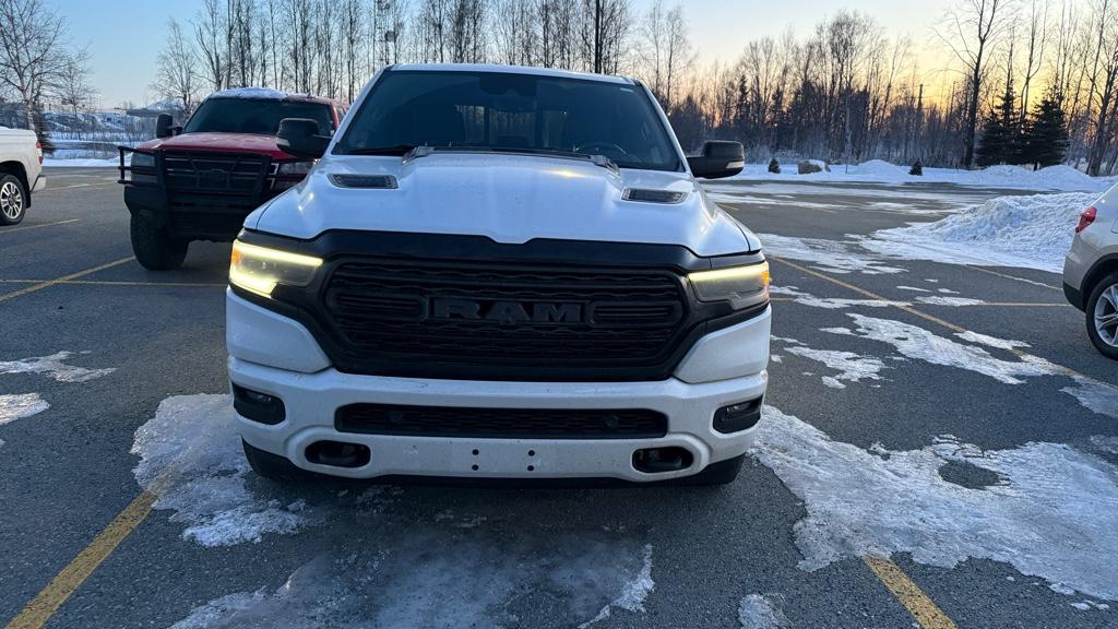

Noticed a couple of days ago that lower end of the day light running lights on the driver headlight is not working.
Is this something that can be fixed easily?

It's not replaceable. You might be able to fix it if you have the skills in electronics.
I could try. Is there any videos or other tutorials available for that?
No, you would need to probably repair the electronics board. There is an aftermarket solution that replaces those with RGB style LEDs.

I had a similar problem on my truck and it turned out to be the Body Control Module (BCM). The dealer changed it out after replacing the headlight and foglight units on the one side didn't fix it.

Did you have to replace the BCM or just reprogram it?
