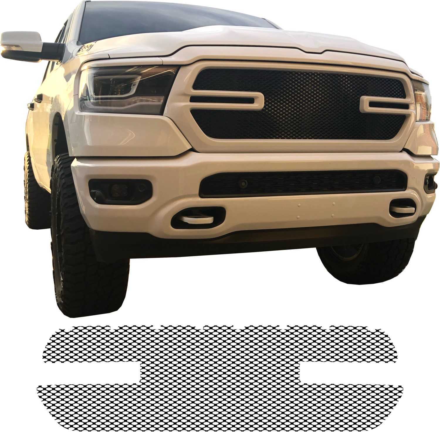

Decided to make a custom grille for the RAM. Ran across some pics of someone else doing the same and knew I had to do it at some point (don’t remember where I saw the initial post).
Anyways ordered some metal from custom car grills and decided to give it a try.
So, basically the Ram grille has 3 parts:
Frame- no mods needed
Middle piece with the RAM logo and all the lines. You basically just cut out all the plastic parts holding in that main piece then you are left with the plastic outline that goes into that outside surround. Everything is held in with clips. So I just trimmed out the metal grille to fit the outside frame with about 1/4 more metal. The hardest part was the rectangle pieces that come out from each side of the grille. With that small plastic of the outside of the grille (color or chrome piece) there isn’t much play.

Adding a couple more pics of the grille taken apart. On the outside piece, you can see the clips that hold the black plastic frame in. Once you cutout all the horizontal lines, the metal needs to be trimmed to fit just inside the clips. Then the outside chrome or color piece clips back into the black plastic frame and the new metal piece is held into place between the 2 with all the factory clips, no glue needed.
Best part, the metal sheet costs less than 100 shipped to do this mod!

Some of you may be interested in this, but the guy that owns custom car grilles was super helpful when talking to him about making the grille. He’s designed a pre-cut piece that will now for the Ram grilles for 2019+ making this install even easier with cutting the mesh the exact size needed.
Check out the link here:
He also has a really nice walk through video of the install process.
I have no affiliation with Matt from custom car grilles, just a really cool guy to work with and this takes out the most time consuming part of this install!
