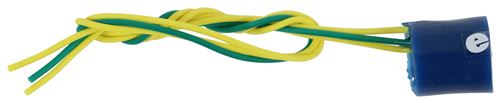

Hi Guys.
I’m just wondering if anyone has the Curt 56584 harness diagram?
I’m trying to add a brake light along with my reverse light set up. Does anyone know which wire on the curt harness to tap in? Or is it even possible?
After digging through google. I found that there is NO wire that is solely for brakes (without left/right turn flashing..)
Much appreciated.

You need one of these

Thanks that’s pretty cool. I’ll look into that! I did found that there is a third brake light wire underneath for toppers. Maybe that’s another option
