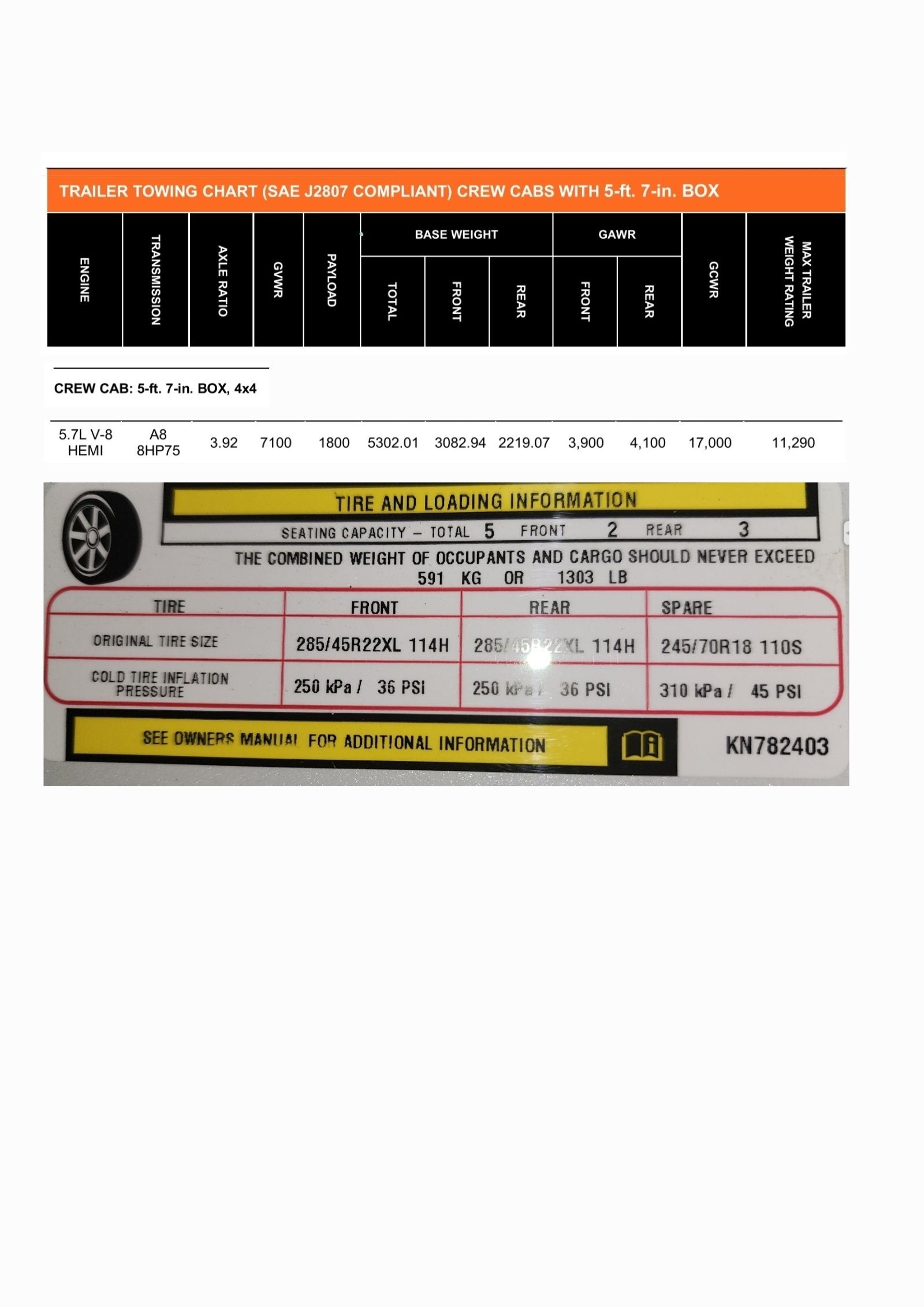

Ii'm trying to verify I'm operating w/n my truck's limits. Are these numbers right?
Payload: 1,300 pounds according to door sticker. So, subtracting my weight and crap I can load about 1k pounds into the truck.
Towing: 11,290 pounds
Plow/Front axle: 818 pounds (3900 front GAWR-3082 front base weight).
- Can I use 650 pound plow/mount? If I subtract my weight from 818, I'm slightly over?

No, the trailer is most likely about 1600 payload so you could not tow it. For that sized trailer, the tongue weight would be about 15% plus the WD hitch.

250 lbs of driver weight is already considered in payload capacity, if I'm not mistaken. And a full tank of gas. You shouldn't need to factor that into your calculations. Still, the best way to know is the cat scale, as stated above.
I don't know what year your truck is, but if you're really trying to follow the rules, my 2020 owners manual clearly states you shouldn't attach a plow.
Wrong. Fuels are accounted for, but no passengers. The sticker clearly states that all occupants and cargo shall not exceed the limits set forth.

I posted this information on plowsite w/ updated information. Seems like the answer is I will probably be OK but with likely increased wear/maintenance costs but a larger truck would be more ideal.
