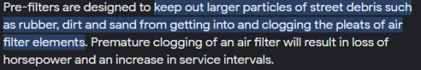

I wouldn't use a CAI on a vehicle primarily driven in the sand as they often come with a high flow filter, like K&N, that also has very low filtering efficiency. This analysis is interesting. Might be OK for a pavement queen. The racing community often uses high flow filters but their engines are tuned to take advantage of them and they don't plan on racing thousands of miles between engine rebuilds.

That's what a prefilter is for. If you are in a dusty environment or driving in dusty environments, you want to use one if you can.
That's not what prefilters are for. They just prevent your main filter from getting clogged as quickly by blocking out larger chunks from reaching the main filter. It still does not block out the fine particles that get past your main filter. They extend air flow efficiency; they do not improve filtering efficiency.
If you say so, but no, sand in dunes isn't considered fine particles. Fine particles as defined by most filters isn't something you will pick up with your hand. But I'm not going to hijack the thread to discuss filter design and efficiency.
I'm not saying so. The sources I provided say so and the source CheYeNNe71 provided also repeated what I said. The testing I previously provided showed in the equivalent of 60 minutes of run time the AC Delco paper filter let through 0.4 grams of dust particles but the K&N would let through at about 15 grams.
If you wish to believe sand dunes do not contain particles small enough to get through your filter then do whatever you want. I can't help you.

Did you actually read what I posted? :ROFLMAO: Dirt and sand.....
Yes, it says exactly the same thing I said. You seem to be ignoring the part where it says it keeps out "larger particles of..." It does not keep out the smaller particles of such items that will get through the filter element.
My guess is you are using a high flow filter and wish to convince yourself that it protects you just as well or better than a paper filter. I'm sure the manufacture told you how great it was. Good luck with that.
last post wasted on you because you will never admit when wrong, proven many times!! Plus your half-*** assumptions! :ROFLMAO: Enjoy!
Again, LARGER PARTICLES. My god, I can't help you comprehend what you read. Everything I have said is supported by sources I provided and sources you keep providing. Do you honestly believe sand dunes only contain large grains of sand? Is that really your argument? THINK.
If you also wish to believe the sand dunes do not contain particles small enough to get through then go for it. The text I repeatedly posted show a high flow K&N filter will let through over 35 times more dirt than a paper AC Delco filter.
