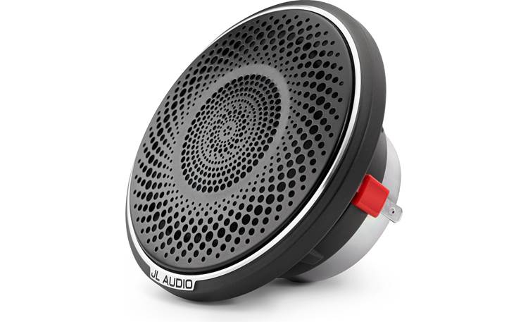

Thanks that helps to know what to order. Did you just swap out the speakers or did you wire those through an amp as well ? I was looking at using the JL Audio C7.
https://www.crutchfield.com/p_13699758/JL-Audio-C7-350cm.html

I put that speaker in center dash. It’s amazing. Also headliner doesn’t get removed. The bezels are held on by metal clips for the roof speakers. They are tough as hell and pushing them back on is tough. I rewired every speaker in my truck with 16 gauge wire.
