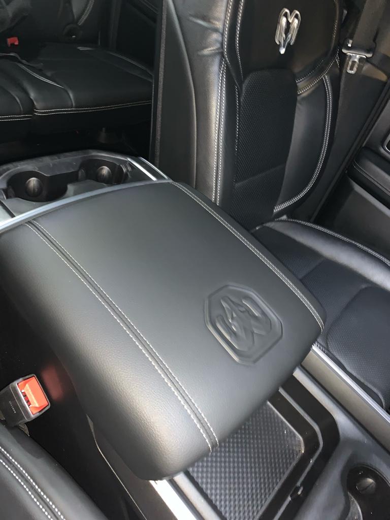

Has anyone replaced their center console lid? Looking for product breakdown to remove. Thanks

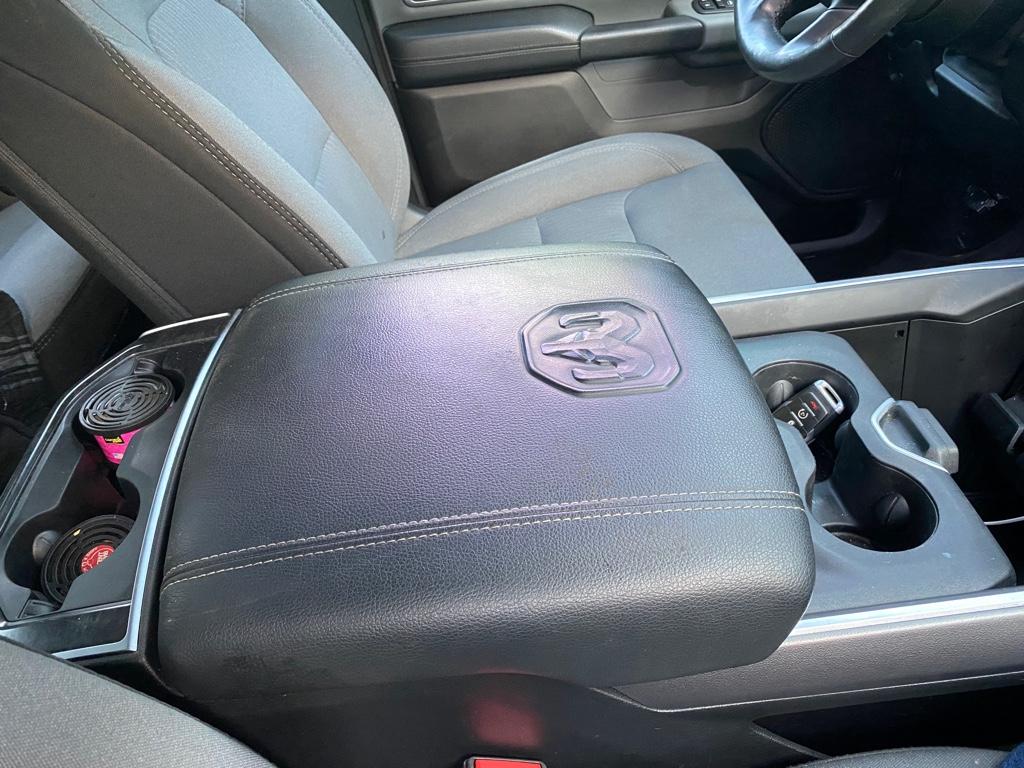

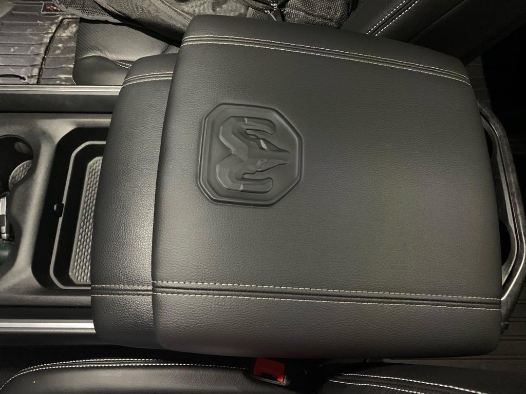

Where did you get the cover with the Ram logo on it?

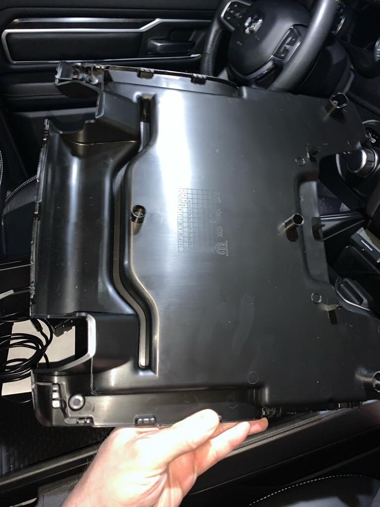

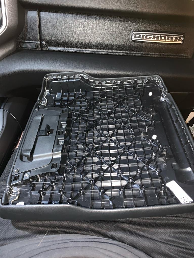

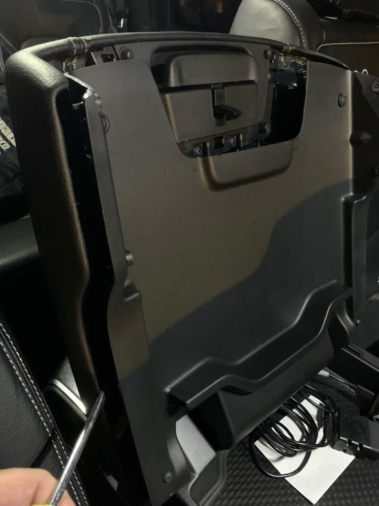

Got it installed. Pop bottom of plastic off top console lid. Then remove 5 screws on hinge and then 4 screws for latch.

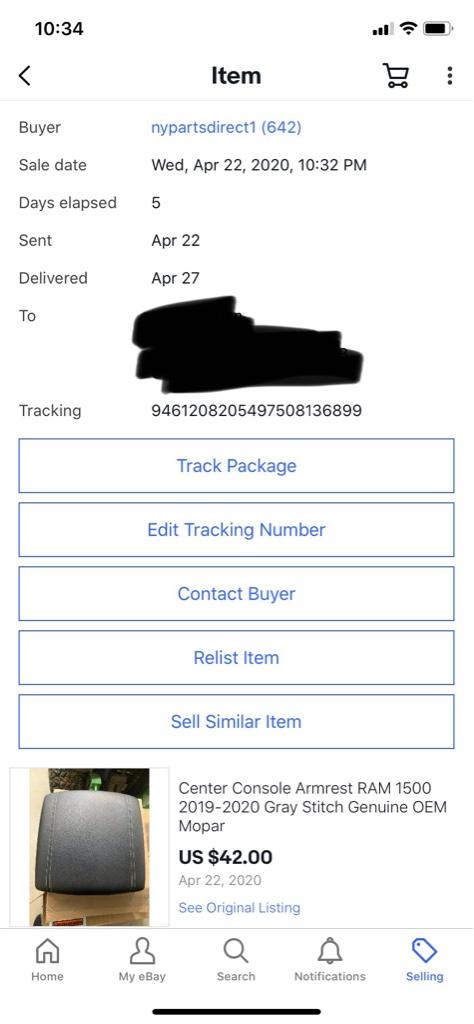

I sold my console lid on eBay and Buyer threw a fit that the whole assembly wasn’t there. I showed him where the whole lid goes for over $200. I gave him full refund. Stay away from this Buyer on eBay if you are selling anything!

So, I have the plain center console lid. Which models have the Ram logo and where can we get one. I have the protractor and stuff under my lid, is that a different design?
Same one I got on. eBay after I damaged original.
So you just pry them apart? I have my new cover and looks like it should just pop off and pop on but don't want to start prying on this thing and screw it up.

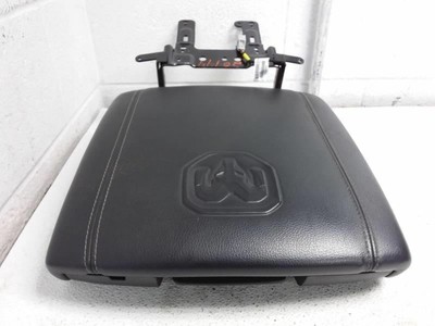

Sorry to dig up an old thread, but the part number of the 19+ model year center console cover with the RAM logo like above is 6WT911X7AA. So just search anywhere on mopar parts and you'll find it. For example https://www.moparpartsinc.com/p/78314020/6WT911X7AA.html
After scratching my Limited center console, decided to replace with the Ram logo one mainly b/c my kids like it better, ha! But it's a great logo and ordering OEM ensures it goes on smoothly.
The top screws off. Can’t remember how many screws I think 6-10 but I did change cover on my old 2019 when I swapped seat and installed center console.
I am still confused on getting this off? Is it just pull up hard and it seperates or are there screws? Do you have to remove the whole lid first then remove cover?
